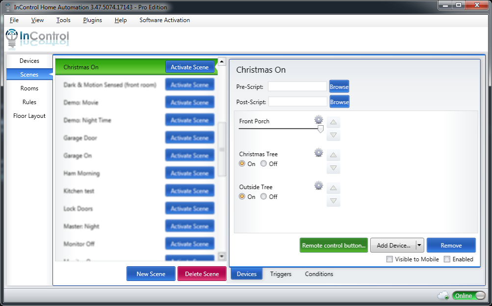

Scenes are a way for your computer to memorize which lights should be turned on and which should be turned off. We'll create two scenes, one with all your Christmas lights on, and another with all the lights off.
From within InControl, click on the Scenes tab. Click the New Scene button. Add all the appropriate modules to your scene using the Add Device and make sure the slider is at full power. Name your scene "Christmas Lights On."
Scene Setup
Now create a 2nd scene and add the same set of modules to it. This time make sure that the slider or the button indicates they are all powered off. Name this scene "Christmas Lights Off."

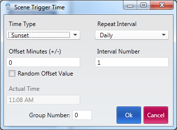

To get your lights to turn on at sunset, choose the "Christmas On" scene and then click the "Triggers" tab. Click "Add Time Trigger" and set the Time Type to Sunset. Everything else will stay the same - but just to be clear: Repeat Interval is daily with an interval number of 1; this is so that our scene trigger will continue to function every 1 day at sunset. If you want to offset your light, you can use the offset minutes. For example, if you want your light to come on 30 minutes before sunset, add a value of "-30" to your Offset Minutes box.
Choose your Christmas Off scene and create the same type of trigger. Again, pick sunset but now enter a value of 180 in the Offset Minutes box. This will tell our lights to turn off 180 minutes after sunset.
